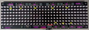

Reverse engineering
lichtkrant PCB
Each panel is 30 pixels wide, 7 pixels high.
Parts:
  • 2x74HC245 (U1/U2): 8-bit bus transceiver with 3-state output
  • 5x74HC595 (U3 and U4/U5/U6/U7): 8-bit serial shift register
  • 1x74HC164 (U8): 8-bit serial-in, parallel-out shift register
  • 2xSTA402A: quad PNP darlington
Power is supplied separately from the 12-pin connector, left of the twin darlingon chips.
Connector (top right):
  • 1: GND
  • 2: pin U2.B0
  • 3: pin U2.B5
  • 4: jumper between U2 and U3
  • 5: ?
  • 6: pin U2.B2
  • 7: pin U2.B3
  • 8: pin U1.OE
  • 9: pin U2.B4
  • 10: GND
  • 11: ?
  • 12: ?
The STA402A transistor base inputs are fed through the set of 7 resistors just left of U3 (595), very likely the row inputs.
The panel has three identical connectors of 12 pins each (they are not electrically identical).
Theory of operation
Possibly the column data is contained in the top chain of 4x74HC595 on top of the board. There are 30 resistors there also, exactly the number of columns.
Actuation of a row is probably done by the drivers inside the twin STA402A. The 595 probably acts as the row selection registers, the twin 245's acting as buffer and twin STA402A's as driver.
It is not completely clear what the 1x74HC164 does.
