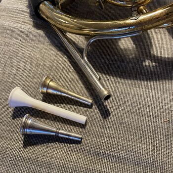

I measured the printed mouthpiece from the original STL, the existing mouthpieces, and the French Horn lead pipe. Most of these measurements are now below.
I tried cutting the existing print down, partially for curiosity about what the barrel would be looking like. Having compared the measurements with the thickness of the PLA print am experimenting with a minimal-thickness barrel in my plastic mouthpiece. I worry a bit that the pressure of pressing on the mouthpiece as I play may distort or shave off layers of plastic as it is forced into the lead pipe.
I tried editing the STL (initially in Blender, now in FreeCAD) to taper the barrel of the mouthpiece. It was possible to use the STL model to give me an initial sense of the appropriate scale.
I was able to taper the thin end of the mouthpiece so it fits in the horn and it works to make music. I am experimenting with ironing the top level of the mouthpiece to have a smooth level - which also requires making the top of the mouthpiece flat.

These measurements are based on my horn (Yamaha 664) and existing mouthpieces. If there are two numbers, it reflects a difference between the mouthpieces.
Mouthpiece length 64.6, 66.8 mm
Mouthpiece rim exterior diameter 25.5 mm
Exterior diameter bore 7.6 mm
Interior diameter bore 6.1 mm
Leadpipe interior diameter 8.00 mm
Mouthpiece outside lead pipe 48.3, 52.8 mm
STL model
Mouthpiece rim exterior diameter 25.6 mm
Exterior diameter bore 9.3 mm
Mouthpiece length 94 mm (approximately)
