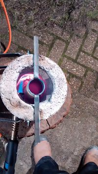

A tiny carbon steel crucible

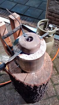

Top of one fire extinguisher as a improvised lid
Gori made a small foundry out of a soup can, a propane blowtorch and some refractory. This works reasonably well and never fails to gather a crowd. It only melts approximately 0.2 l of aluminium, and this is clearly not enough to do any real work.

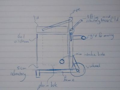

Semafoor is gathering materials to build a second, much larger furnace out of a 60 l oil drum. Should look something like this >.
Key points are:
  • Movable on its own wheels because it will be heavy
  • A lid to reduce the heat loss at the top (big problem in the soup can furnace
  • Incorporated device to lift the lid up and to swing it to the side
    • Lid will be mounted on a tube that will slide into a larger tube of the frame
    • Lever + Cam to lift the lid a couple of cm, to be clear of the bottom part of the furnace
    • Same lever will be used to swing the lid sideways
  • about 5 cm of refractory all around. Probably a bit more on the lid for rigidity

Barrel
A 60l oil drum has been acquired. It now needs to be separated into a part for the lid and a part for the lower body. The lid needs some reinforcement to be lifted and to keep the refractory in. The lower body needs a drain hole (in case of crucible failure, to let the molten metal out) and an air intake hole for the burner flame.
The dimensions of the barrel are 590 mm high and 375 mm diameter. With a suspected 50mm refractory lining this should give an inner diameter of around 250 - 275 mm. Inner height would be around 450 mm (excluding a plint for the crucible to sit on. Maximum crucible dimensions should be around 200 - 250 mm outer diameter, and a height of 350 - 400 mm.

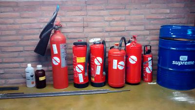

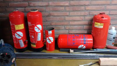

Wvholst as found some fancy Silicon carbide graphite crucubles on Aliexpress. These are definitely worth looking into when everything is in proper operation. Before that time, a steel crucible (welded from pipe, or just from some fire extinguisher bottle or something like that) should give us a dozen or so melts to get acquainted with the process
Half a dozen fire extinguishers as building material
Empty and chopped fire extinguishers
