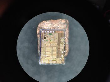

We bought some Dallas DS18B20 temperature sensors from Aliexpress, at a price that just seemed too good to be true. Upon inspection of the die inside, suspicions of funny business were confirmed. Some clearly visible branding on the silicon itself indicates that these are actually a QTEK part. QTEK is a Chinese manufacturer that markets an 18B20 clone under their own banner, but their parts clearly also end up in the hands of less scrupulous resellers, who are happy to pass them off as genuine.

Die with visible 'QTEK' markings
