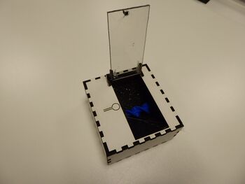

| ESP8266 automatic fish feeder. | |
| Status | Completed |
| Contact | colomax |
| Last Update | 2024-01-17 |
Just dispenses (fish) food using a 3D-printed (archimedian) two flute scew. It uses a modified servo motor to drive the scew, such that it no longer has angle limits. A secondary servo is installed to open a lid of the fish tank, as well as a vibration motor to make the dispenses more consistent. An additional relay can be installed to control some form of lighting.
It is intend to be used stand-alone, but because it is written using the esphome project, it can easily be integrated in the rest of your home-automation.
Source code and (updated) design files are available in the repo.
