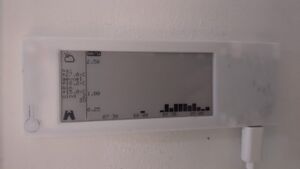

| Project De Weer | |
| E-ink display with detailed rainfall data. | |
| Status | Completed |
| Contact | colomax |
| Last Update | 2024-01-14 |
Source code and design files available at request. Uses on the inside a standalone ESP8266, which for the most time is in deepsleep.
Uses a undocumented API from buienalarm.nl and as fallback a documented api from buienradar. Also used data from the KNMI for other weather data (via api) and via webscrapering data from kanikeenkortebroekaan.nl.
Also working on a battery powered version, but due to the type of E-ink display, lack of advanced sleepmodes and tight power requirements, is still in the process of a considerable rewrite.
