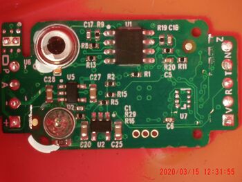

The AQC-0-0-0-0 is a CO2 sensor, much like the MH-Z19B. We have no idea who makes these and where they can be bought, but it's an aesthetically pleasing device that seems to work at least as well as the famous MH-Z19B. It has the same form factor and is pin compatible. Regarding the protocol it is only (somewhat) compatible with the MH-Z19 for the commands 0x86 and 0x87.
The sensor communicates using 5V-tolerant 3.3V TTL serial, 9600 8N1.
Since the datasheet is lacking in instructions on how to use it, and information about the sensor couldn't be found online anywhere, we've tried to reverse-engineer the device to figure out the protocol.
Teardown
Bottom of PCB, as visible without destroying the sensor
Top of PCB (inside)
Case removed
