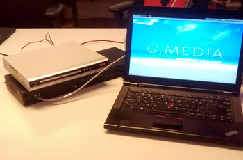

POIDH
The Verint Nextiva S1708e video encoder connected to a freestuff dvd player (as test video source) successfully streaming to my laptop.
