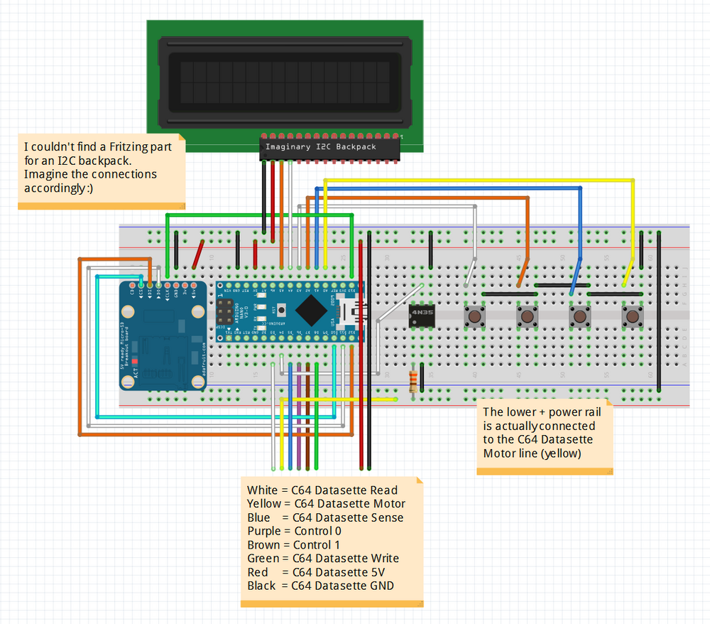

Now that the broken datasette appears irrepairable I thought of another use for it. I'm planning to build an SD2datasette device, a plugin for the datasette port of a PET VIC or C64 that works like the CASDUINO, but for a datasette port. I can built one into a datasette in the dataette, and put the display below below the transparent ejection lid, and put its buttons below the display. And use the datasette cable for the connections to the arduino. I leaned that you can buy the PCB for it at PCBWay.
8 may 2024 Started with a Datasette with an Arduino and Sd-Card
Found a fritzing Diagram of a "casduino" for a C64/PET Datasette. Started with converting the diagram to a KiCad schematic, using the TZXDuino Pico as example, so that I don't need to use a separate SD-card interface board, or 3V3 regulator. this DATASETTE-Duino uses a 2x16 LCD with an I2C backpack..
