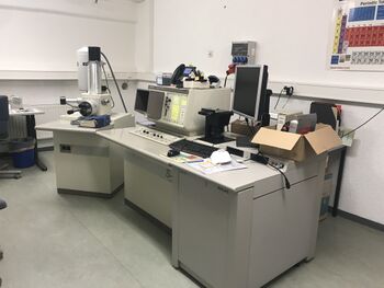

After a quite adventurous trip to Germany (many thanks to User:eightdot for his help) we have succeeded in moving the SEM to Overgoo 1.
It is now located in the Absolute Unit down the hallway from RevSpace.
We have had to repair several things:
  • Remove rodent excrement from the SEM: full teardown of electronics and rebuild
  • Replace the scintillator disk as it had degraded.
  • Add shims under the vibration dampers as they had degraded leading to the column resting on the shipping posts
We are also working on adding some features such as a:
  • Webcam chamberscope, with help of the Frees
  • BSE detector (also with help of the mill, not done yet)
