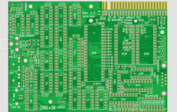

Layout ZX81+38 rev 1,5 finished and checked
This is the new layout of revision 1.5, it has been checked for DRC errors, and this is a screenshot of how the PCB will look like true size is 142mm wide and 100mm deep, so this picture is nearly true size (depending on your monitor): Top
and bottom:

Actually I was wrong, and the new routing wasn't actually needed, it was just that the pullups of 4K7 are just a bit too strong, and should have been 10K, with 4K7 the resistor divider created by the 1K address-series resistor, and 4K7 pullup made it that the logic level on the keyboard data line of a pressed key would not go low enough, and if you pressed a second key an illegal logic level could exist on A8' with 10K pullups this would be much less likely. Still, there is no reason to return to the old layout with A8' connected to D6, the original ZX-81 did that too (easier to layout I presume) so Ill keep this layout, only changed the schematics to a resistor array of 6 x 10K instead of 6 x 4K7. I kept the version number the same (rev 1,6)
This is the new TOP side of rev 1,6
and this is the bottom side:
