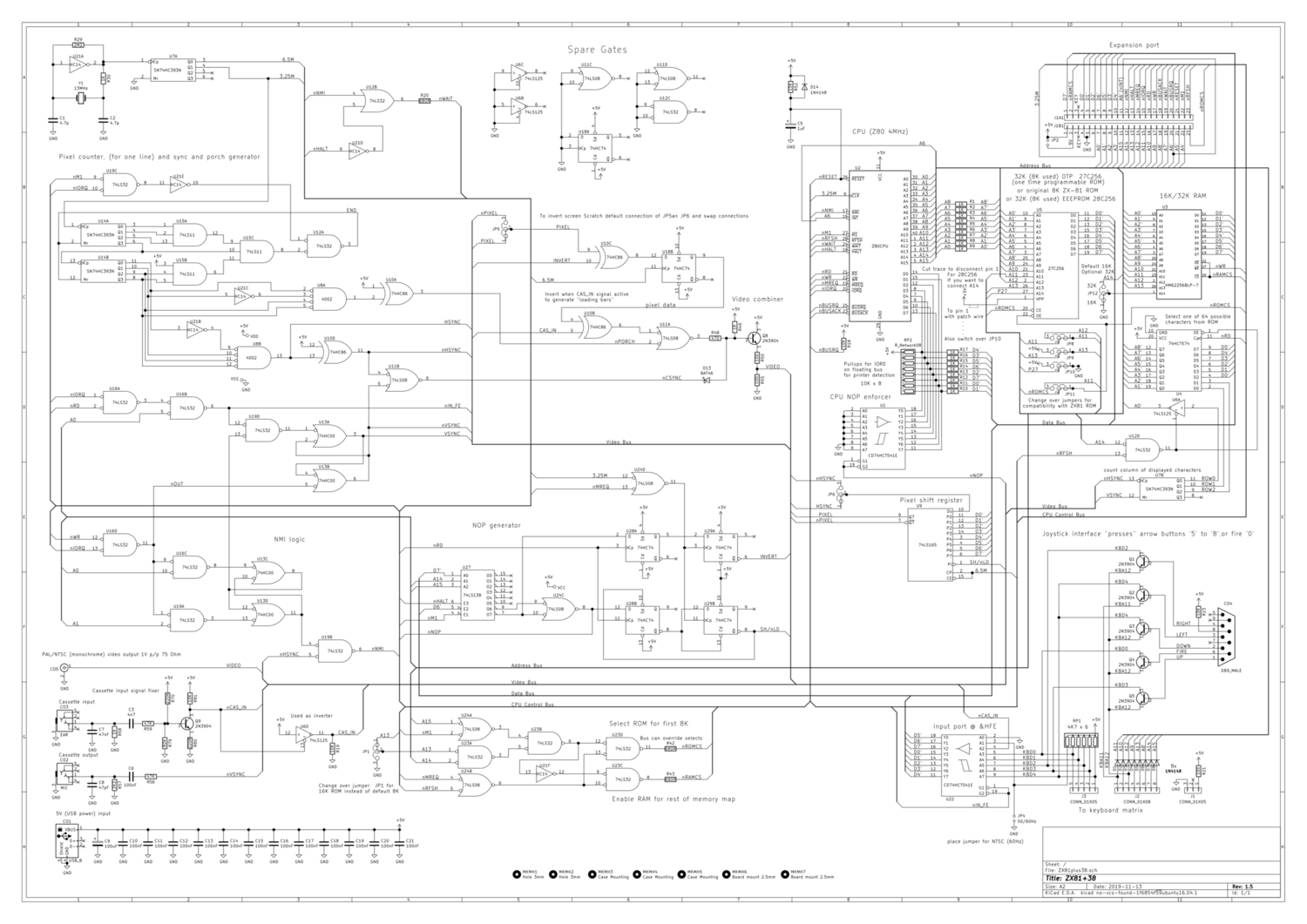

I started analyzing my current schematic, to see whether it contains components that are not available in PTH, and unfortunately there are some, for example "unbuffered inverters" (74HCU04) used in the crystal oscillator, are no longer available in DIP. Also some other logic isn't available in DIP, 13MHz crystals are hard to get in PTH versions, and 6.5MHz are not available at all. I decided to switch from 128K flash ROM to 32K OTP ROM's because the latter are available in DIP-28, while for the former I MUST use a PLC-32 socket. Eproms are a few dimes more expensive there days than OTP's, but DIP sockets are much cheaper than PLCC PTH sockets, and OTP and RAM in DIP-28 placed next to each other are much easier to layout. I also found cheap 32K x 8 static RAMs, also in DIP-28, which will be easier to layout for.
I will design it with KiCad unlike the older version which was designed using Ulticap and Ultiboard.

October 9, schematic rev1.0 finished
Schematic finished for rev 1.0, updated schematic File:ZX81plus38.pdf, plus preview schematic pictures. Next up, importing the components in the PCB layout, and placement of the parts. No attempts have been made yet to try to support multiple types of ROM/EPROM/FLASH, like the original ZX81 ROM. But this schematic should be complete. New is my attempt to support the canonical cassette loading video bars.
October 13, 2019, schematic rev1.1 (some errors fixed, added ZX81 ROM support)
Found, and repaired some errors, when doing electrical rule checking, (non connected power supply pins, no footprints assigned, such errors). nNMI is now directly connected to A6, without a resistor in-between. Improved the way cassette input shows up as loading bars by using and AND port. Noticed many labels where the "'" (bis) marker was changed to something very similar, but resulting in no connections between various connections having a "'" (bis) sign in the label, checked all nodes with a bis marker (D0' to D7' and A0' to A8') for connectivity, and repaired the labels with a problem. Also, I corrected some labels where I used the backslash to denote in inverted signal, instead of the lowercase "n" I used everywhere else.
also found a small error in the original ZX81 schematic, which claims that the D7 signal is NOT connected through a 470 Ohms resistor, but actually, it IS! (I measured 470 ohm between pin 13 of the Z80 and pin 1 of side A1 on a real ZX-81), so the "D7" label on the expansion connector should have been written as "D7'".
Added several 3-pin jumpers so that the EEPROM socket can be configured to accept a ROM from a real ZX81, These jumpers are pre-connected, and per default configured for a 27C256 EEPROM, two of the jumpers can also be used to select one of four possible 8K images that can be contained in a 27C256, per default only the first 8K is used. Jumpers will be "virtual", meaning they will probably be mounted on the underside of the PCB under the EEPROM, and to change for a ZX81 ROM you will need to scratch through the pre-connection between pin 1 and 2.
All components are now cleanly forward annotated, so next job will be component placement.
Schematic is now revision 1.1 File:ZX81plus38 rev 1.1.pdf
October 15, 2019, finished schematic rev1.2 (functionally complete)
Added support for loading bars, using spare gates, only new part is one pull-down resistor. added some explanatory texts, changed U22 so that its wiring is optimal for keyboard column readout placement. converted the logic type to active low logic symbols where that was more logical, so its easier to follow the logic.
This schematic should be functionally complete, (if nothing unexpected happens) changes beyond rev 1.2 should only consist of pin or component swapping optimizations, and component renumbering (after I did the placement).
Revision 1.2: File:ZX81plus38 rev1.2.pdf

Revision 1.5 with various corrections should now be working
In this schematic all the reported faults and requested improvements are implemented. File:ZX81plus38rev1,5.pdf
The following changes were made:
  1. C1 and C2 of the crystal oscillator were lowered to 4.7pF
  2. the signal n6.5M was removed, and flip/flop U18B was clocked with the non inverted clock 6.5M
  3. the removed inverter U21D was used to build a new WAIT generator circuit in place of U18A, together with OR port U12B. the previous version did not work mainly because of the flip/flop not working as a WAIT generator. To be able to externally for the /WAIT signal low a resistor R20 was placed in series with the nWAIT output.
  4. The RCA PSG01546 plug had a wrong footprint, and so could only be place 180 degrees rotated (not that it would work if you did). I found a replacement RCA plug that could be inserted, the CLIFF FC68391, and updated the footprint for a perfect fit
  5. on the expansion connector I had swapped A13 and A14, so I corrected it
  6. also on the expansion connector JB1 pin 2 was tied to +5V, but this pin was meant for +9V, so I put a jumper between +5V and this pin, so the pin can be jumpered to +5V or tied to an external +9V source
  7. The ROM socket was designed for an OTP (one time programmable, an EEPROM without its glass erase window) and with wire links on the bottom you could (re-jumper) by scratching a track and wiring between the other pads the socket for the original ZX-81 ROM.
Some users asked if I could also support EEEPROMS, and although this was already possible pin 1 (A14 on an EEEPROM) was tied permanently high, so I made it that you could disconnect Pin 1, and tie it to something else, like a switch.
  1. i had created the option to invert the video with two jumpers JP5 and JP6, but got the complaint that if you forgot to place these two jumpers you would get no video, so I also pre-connected these two jumpers for default white screen with black letters.
Its still possible to get a black screen with white letters, but you have to scratch through the default pre-connects, and add a wire link
  1. I got asked why the keyboard wires were not simply one strip of holes with a 2.54mm pitch,but was deliberate, the previous version has three extra holes for a power LED, and a reset button, ad I had removed these. So I added three holes, and put all holes in the same raster. Its possible to have a power LED on the keyboard now.
  2. I enlarged the mounting hole bottom left, above the text "ZX81+38"two as requested.
  3. Jumper JP1 was wired "in reverse", but as A13 was correctly connected to pin-1 of U23A that wasn't a problem
If you have a revision 1.4 PCB, you can get it working by doing three things:
  1. Use OTP's, not EEEPROMS (which are six times more expensive anyway) and fill the 32K rom with four copies of the ZX-81 BASIC.
  2. Remove the output of the flip flop U28A, so that /WAIT is not driven,
  3. and replace the WAIT circuit with either the two transistor improved wait circuit from wilf ritger, or the wait circuit of revision 1.5 with an inverter and OR port
  4. disconnect U18B pin 11 (clk) from the inverted 6.5MHz clock, and tie it to the non inverted 6.5MHz clock, closest point to connect to is pin 2 of the shift register 74LS165 (U9).
Now the clone should work.
