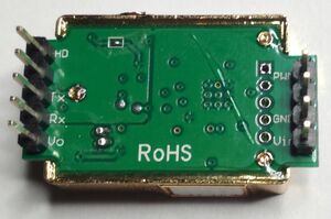

Back side of the MH-Z19B sensor with unlabeled SWD pads on the right
MCU firmware can be easily dumped through SWD test pads. Pinout:
Pin Signal
1 (square) 3V3
2 GND
3 SWDIO
4 SWCLK
5 RESET (active low)
Additionally, bootloader asks for a firmware update during the first 20s of startup.
