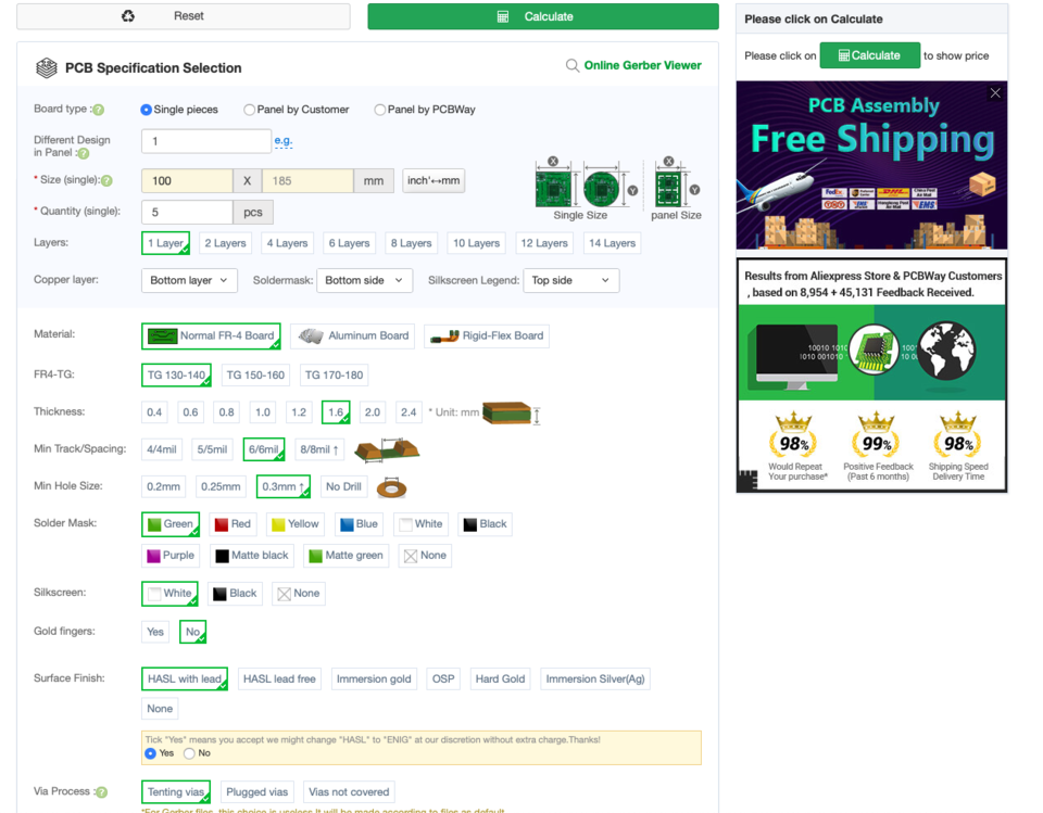

Ordering the main PCB
This is the page where you can choose from all the available options, in this case Iḿ ordering the 100mm x 100mm dual sided main green PCB, with white silkscreen, and standard thickness (1.6mm) and default PCB material. Where possible always choose the default options.
Ordering the keyboard PCB
This is the screenshot of the options for the single sided keyboard PCB, measuring 185 x 100mm. Note that I opted to give the PCB manufacturer the choice over the type of surface finish, this makes pooling these PCBs easier, as the manufacturer can choose in which panel-stack with a specific finish he can pool these PCBs.
