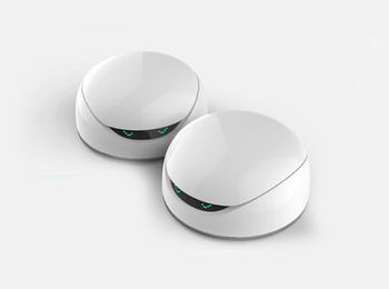

I've got four DFRobot 'Vortex' units. Basic programming via the official apps is possible, but rather limited. The WhenDo app is only available on iPad. Luckily, the internal Arduino clone can be directly programmed too. Unfortunately, not all the specs seem to be available, but there are some examples to work with, although they have a quite a bit of 'magic numbers' in them. These examples might disappear, so duplicating them here, with my own notes as available. The examples-coding is mostly done by "Andy Zhou <Andy.zhou@dfrobot.com>", although I did change some of the things to figure out what they do.
http://wiki.dfrobot.com.cn/index.php?title=(SKU:ROB0116)_Vortex%E5%8F%AF%E7%BC%96%E7%A8%8B%E6%9C%BA%E5%99%A8%E4%BA%BA#.E6.A0.B7.E4.BE.8B.E4.BB.A3.E7.A0.81
https://www.dfrobot.com/wiki/index.php/Vortex_Arduino_Coding_Tutorial_V1.0#Introduction
(Chinese page seems to have a bit better documentation, although English page might be easier to read and it is interesting to compare the differences)
