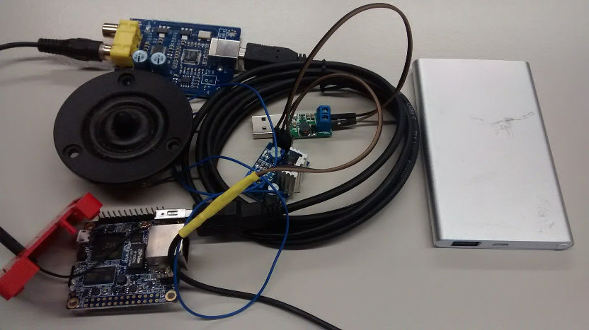

The hardware consists of the following parts:
  1. Some kind of media player which takes care of the storage and playback of the ultrasonic files, for example a single-board computer like a Raspberry Pi
  2. A USB audio card to create the analog ultrasonic signal
  3. An amplifier to amplify the ultrasonic signal
  4. A speaker to turn the signal into actual ultrasonic audio

parts to be integrated
The various parts have the following dimensions (length x width x height):
  • USB battery: 111x 68 mm (without plugs)
  • USB audio: 66x51 mm (PCB only), 77x51 mm (including connectors, without plugs)
  • speaker: 66 mm (outside diameter), 52 (mounting hole diameter)
  • orange pi zero: 48x46 mm(PCB only), 54x46 mm (including USB and sd card connector, without USB plug)
  • amplifier: 32x25x24mm
  • step-up converter: 42x15x12 mm (without plugs)
