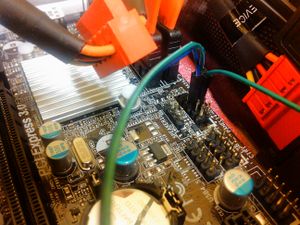

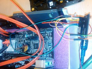

I was building a 3-node cluster to test some cluster-filesystems for a client, and used 'wake-on-lan' to remotely boot the various cluster nodes when needed. This worked somewhat, but I was unable to reboot a hanging system, or see if a wake-on-lan packet actually arrived at the system.
Doing some tests with a firmata sketch on an arduino proved that I could easily toggle the powerbutton and resetbutton on an ATX mainboard, bringing this project to life.

  • Connect the arduino to a usb port on a working system (I used a openwrt based router).
  • Connect the digital pins to the power and reset lines on an ATX mainboard.
