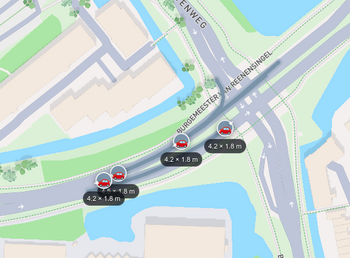

Introduction
This page is about investigating reception and processing of so-called C-ITS or ITS-G5 signals (802.11p) as used in the Netherlands, see also https://en.wikipedia.org/wiki/Vehicle-to-everything These signals are exchanged between passenger cars, emergency vehicles, traffic lights and other traffic-related equipment.
An ESP32-C5 development board is capable of receiving WiFi in the 5 GHz band and can receive/sniff these kinds of packets from live traffic.

- Crowd-sourced live map of messages received: https://opentrafficmap.org/ Their wiki: https://wiki.opentrafficmap.org
