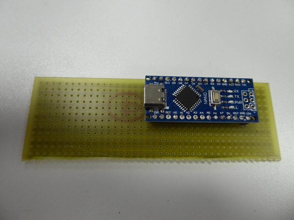

PCB for the arduino nano
started with a (perfboard) PCB after creating a socket for the arduino nano.
