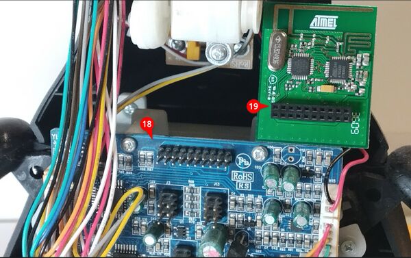

  2. Replace the wireless dautherboard (item 19) in de TuxDroid with a RPi Nano, ditch the Fish (item 2)
Level 2: Replace the entire “guts”
  1. Keep the motors, cabling, sensors
  2. Replace the mainboard (item 18) with modern motor control, replace the built-in battery (item 14) etc…

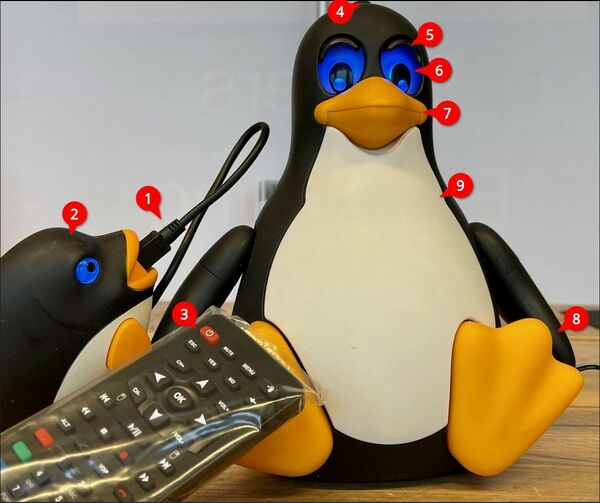

Front
  1. USB mini cable to connect the Fish to computer
  2. TuxDroid Fish – to remote control the TuxDroid from your computer
  3. IR Remote – reciver behind the eye of the TuxDroid
  4. Button
  5. Eye lid – can open and close; remotely controlled from computer
  6. Eye – blue LEDs behind the eye can light up; remotely controlled from computer
  7. Beak – can open and close; remotely controlled from computer
  8. Flippers – can move up and down; remotely controlled from computer
  9. Body – can turn left and right; remotely controlled from computer

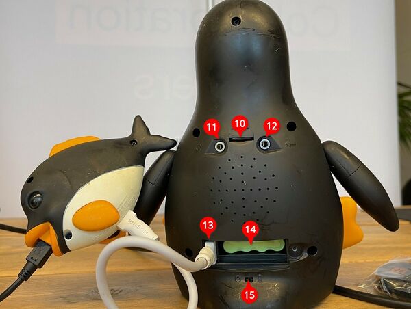

  1. Volume control of the internal speaker (item 17)
  2. 3.5mm jack for headphone
  3. 3.5mm jack for external microphone
  4. direct connection for firmware upgrade from the Fish
  5. built-in NiMH battery (4.8V, 750mAh)
  6. on-off switch for the TuxDroid
  7. external power jack for the TuxDroid
  8. built-in speaker

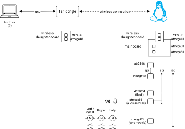

  9. TuxDroid main board – based on 2x Atmel ATmega88 providing “core” and “audio” modules to controls, e.g.: motor, IR, audio etc functions
  10. TuxDroid wireless daughter board – based on 1x Atmel ATmega48 and Atmel ATR2406 2.4-GHz ISM Transceiver (the exact same board is also in the TuxDroid Fish)
Schematics
