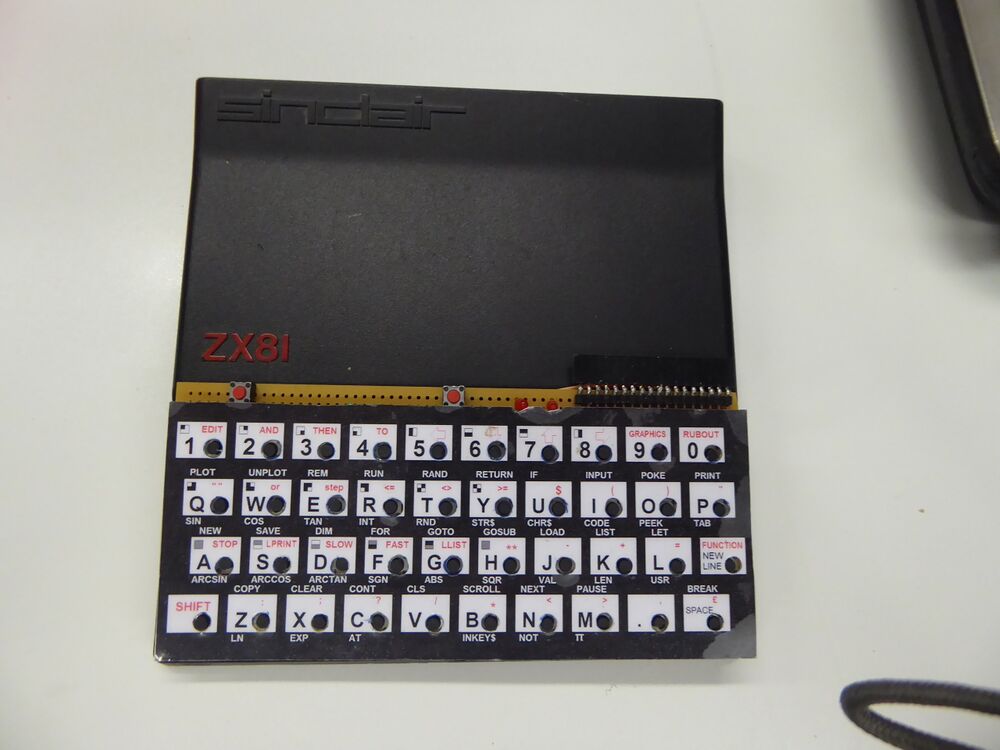

The size of the keyboard is almost exactly right, only I have added reset buttons, and two LED, and the edge connector sticks out a lot. see:
[[File:ZXkeyboard on top of ZX-81.JPG|1500px]]
[[File:ZXkeyboard on top of ZX-81.JPG|1000px]]

August 23, 2022 Modify prototype keyboard to fit on top of ZX-81
also I'm busy with modifying my old prototype keyboard for my ZX81+35 so that it works as a replacement keyboard for the foil keyboard of a real ZX-81
so I will remove these parts and wire two flat cables directly to the keyboard PCB.
