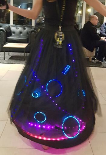

To do
  • Reinforce wire connections with hot glue and/or zip ties.
  • Punch and grommet holes where velcro used to be.
  • Buy or make a carrying case (width ~80 cm, height ~110 cm), maybe pop-up tent bag.
  • Make LEDs addressable by position.
  • More programming designs.
  • Get aurora borealis palette working properly on circles and panel, and shooting stars display on strips.
  • Replace (or add to) strip in bottom tube with side-emitting LEDs?
LED count
  • 240 - circles (all used except one)
  • 64 - 8x8 panel.
  • 23 - strip 1.
  • 23 - strip 2.
  • 17 - strip 3.
  • 84 (?) - strip along bottom tube.
Total: 451 LEDs.
Timeline
Construction
2019-11-06 - 2019-11-11
Bought:
Old sketches:
2019-11-12 - 2019-11-24
  • Played with layout of LEDs, waiting for items to arrive.
  • Tested out LEDs under layers and on crinoline.
2019-11-25
  • Took apart seams of inner layers of black skirt to add extra panels to fit over crinoline.
2019-11-26
  • Measured skirt on top of crinoline. Extra panel with bottom arc length of 100+cm.
  • Decided to go with 6 strips of 23 LEDs each. Cut one strip.
2019-12-03 - 2019-12-05
  • Tested out LED rings. One wire was detached so had to be soldered on.
2019-12-06
  • Punched holes in crinoline, used zip ties to attach first LED strip.
  • Took apart LED circles and tested FastLED programs.
  • Set up LED circles, one strip, and panel together on crinoline and used zip ties to place everything but the panel on crinoline.
  • Ran FastLED programs on everything together.
  • Pictures posted by others to Facebook, RevSpace kiekjes, Twitter.
2019-12-20
  • Rearranged LED circles, mounted some back on with velcro. Mounted panel with velcro.
  • Cut two more strips. Attached wires to one and mounted it horizontally at an angle.
2019-12-22
  • Folded up bottom hem and put velcro strips all across to partially make a tube along bottom.
2019-12-24
2019-12-25
  • Measured and cut panel for black layer of skirt.
2020-01-10
  • Used fabric glue along bottom hem tube, in between velcro strips.
  • Soldered wires to more LED strips.
2020-01-11
  • Soldered wires to remaining LED strips.
  • Connected everything together, hooked up to an Arduino.
2020-01-17
  • Added more velcro bits to fix placement of LEDs.
  • Experimented with modifying FastLED programs. BPM on circles?
2020-01-18 - 2020-02-13
  • Experimented more with FastLED programs.
  • For custom color palettes, used PaletteKnife bookmarklet to generate codes for palettes. Add to sketch directly, or add to Arduino/libraries/FastLED/colorpalettes.cpp and palette name to colorpalettes.h.
  • Cut up plastic bag for panel over skirt, attached with velcro.
  • Finished up everything on black outer skirt.
  • Bought 2x SilverCrest power banks.
HackerHotel 2020
2020-02-14 -2020-02-16
  • Debut as Princess of Lights went excellent, with paparazzi taking pictures and video all weekend.
  • About a dozen wires broke off throughout the weekend and had to be soldered back on, some with reinforcements of zip ties to hold them in place.
  • LEDs kept weighing down crinoline, and since the string in the waist came out a long time ago, the velcro was not enough to hold it up. Used an opened paperclip to hold it together, and then a safety pin. Need to add a hook fastener, or use a large safety pin (through grommeted holes) or some other kind of fastener.
