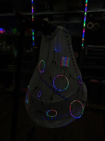

LED count
- 240 - circles (all used except one)
- 64 - 8x8 panel.
- 23 - strip 1.
- 23 - strip 2.
- 17 - strip 3.
- 84 (?) - strip along bottom tube.
Total: 451 LEDs.

2019-12-06
- Punched holes in crinoline, used zip ties to attach first LED strip.
- Took apart LED circles and tested FastLED programs.
- Set up LED circles, one strip, and panel together on crinoline and used zip ties to place everything but the panel on crinoline.
- Ran FastLED programs on everything together.
- Pictures posted by others to Facebook, RevSpace kiekjes, Twitter.

2020-02-14 -2020-02-16 - HackerHotel 2020
- Debut as Princess of Lights went excellent. Paparazzi taking pictures and video all weekend.
- About a dozen wires broke off throughout the weekend and had to be soldered back on, some with reinforcements of zip ties to hold them in place.
- LEDs kept weighing down crinoline, and the string in the waist came out a long time ago, and the velcro was not enough to hold it up. Used an opened paperclip to hold it together, and then a safety pin. Need to add a hook fastener, replace velcro, or use a large safety pin (through grommeted holes).
