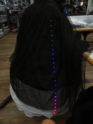

  • Have six vertical stripes, circles of varying sizes, and 8x8 panel. Figure out layout.
  • Want side-emitting LEDs along the bottom, but can't find side-emitting LEDs that are also waterproof, and can't put more than 1m of non-waterproof ones in a silicon tube.
  • Diameter of crinoline bottom hoop is 80 cm. Need to add an extra 100+cm of arc length of black paneling and tulle paneling to inner layers.

  • Layout of LEDs, waiting for items to arrive.
  • Tested out LEDs under layers and on crinoline.
2019-11-25
  • Took apart seams of inner layers of black skirt to add extra panels to fit over crinoline.
2019-11-26
  • Measured skirt on top of crinoline. Extra panel with bottom arc length of 100+cm.
  • Decided to go with 6 strips of 23 LEDs each. Cut one strip.
