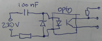

Circuit
The circuit on the right is the one I plan to use.
The capacitor drops most of the voltage. It should be an x-rated type, you can tell by the marking "X2". The resistor (1k or so) limits the inrush current. The diode (1N4148 probably) protects the optocoupler (4N27 or 4N35) from reverse voltage. The resistor on the right is a pull-up resistor, possibly not even needed if I use the built-in pull-up of the microcontroller.
The X-capacitor, even though it is designed for connection to mains voltage and referred to as a "safety capacitor", has a failure mode to most likely fail as a short. This means additional components are needed to make it actually safe to use in this circuit, like a fuse in series that blows when the capacitor fails. (maybe I should just use an Y-capacitor then, which has a failure mode of most likely failing open)
At 50 Hz, the capacitor has a reactance of about 32 kOhm, so the LED current should be something like 230V/32kOhm = 7 mA, well below the maximum of 60 mA mentioned in the data sheet. Possibly, a bleeder resistor could be put parallel to the capacitor, to make sure that the capacitor doesn't stay charged when the circuit is powered off. Power consumed in the resistor is R*I*I so about 50 mW, so we can probably use the very common 250 mW type there.
