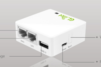

GL-iNet.com creates nice clones of TP-Link WR-703 routers. They run OpenWRT out of the box, and have 2 ethernet interfaces, a 2.4Ghz Wifi (802.11n) radio, a usb2.0 port and 5 free GPIO ports (2mm spacing). Available on dealextreme/alibaba or in the RevSpace vending machine.

Model GL-iNet 6408A / 6416A
CPU Atheros AR9330 rev 1 - MIPS 24Kc V7.4 (265.42 BogoMIPS) 400Mhz
Ram DDR 64MB
Rom 8MB (6408A), 16M (6416A)
Interface 2× 100mbit/s RJ-45 (LAN/WAN), 1× USB2.0, 1× Micro USB (power)
LED Red and green. When both turned on amber-ish.
Wireless IEEE802.11n/g/b、IEEE802.3、IEEE802.3u
Button Press to toggle wireless radio; Press and hold for 8 seconds to restore factory default settings
Antenna Inverted F PCB trace antenna DN007 *1 https://www.ti.com/lit/an/swru120b/swru120b.pdf http://hackaday.com/2014/02/28/pcb-antenna-reference-designs/
DIY Features Uboot web interface; UART soldered 3 pins (2.54mm spacing); 5 GPIO (2mm spacing)
Power Supply 5V/1A micro USB (not included @ RevSpace market)
Size 58mm*58mm*22mm
Weight 42g (router only)
Power Consumption Less than 1 watt
Temperature Working temperature 0°C - 45°C. Storage Temperature -40°C - 70°C
