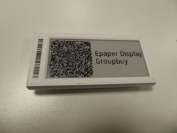

Info for tags and AP sold in https://revspace.nl/Epaperinkoop
This is just a Wheeze_NL braindump for now, it might help you get started
There is a very nice project, reusing epaper pricetags from grocery-shops etc.
The project is called OpenEPaperLink and was kickstarted by dmitri.gr who reversed engineered the firmware and created a new open-source firmware for Solum pricetags.

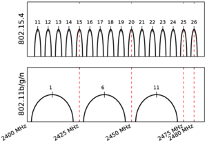

On the topic of the RF-interface
As written before, the protocol written for these tags are using the IEEE 802.15.4 spec. The image shows the overlap with the 802.11bgn wifi channels, choose wisely (and please add other tech running on these frequencies)
Suggestion; use 26. While 25 is also "outside" of the Wi-Fi channels, it is still caught in the sidelobe of channel 11 (of Wi-Fi). In case you're running Zigbee, 25 is recommended for that, as 26 is not universally supported.
image from researchgate.net

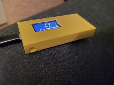

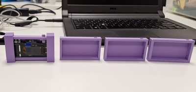

Case
Nemo's version:
https://www.printables.com/model/1133397-nemo-de-beun-epaper-access-point-case
Bas' version
https://github.com/sebastius/openepaper_diy_ap_doosje
https://makerworld.com/en/models/956364
